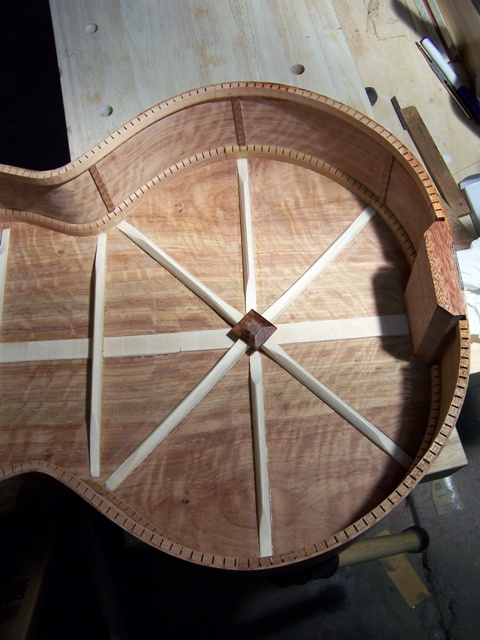

Here is your picture. This is an SJ
MichaelP38971.3781481481

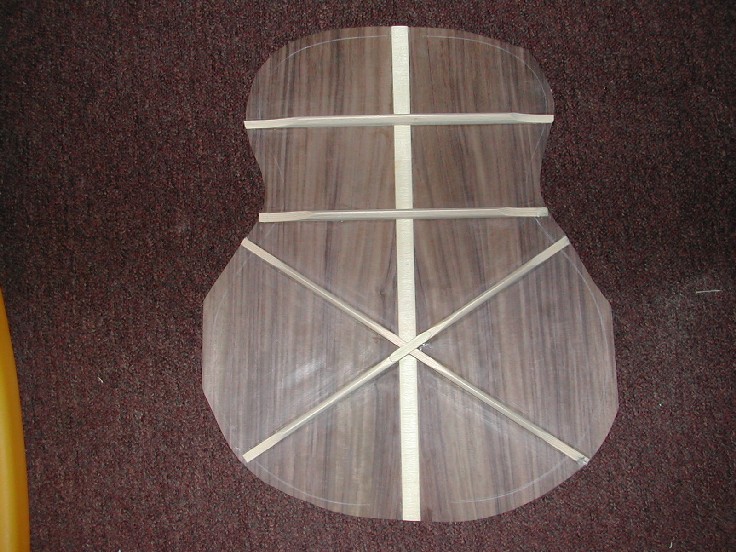

J.,
Here's a pic of mine(I know, the X is off). This was my 2nd guitar, and I really love the sound of it. I love X braced backs, I think they look cool and sound better. To my ear, at least.
PostPosted: Mon Sep 11, 2006 11:46 am
Posts: 3933
That's about the layout I use. I generally end up with the X tall in the middle and tapered off, and the waist bar quite small, but that's just what seems to work for me. The X angle is probably important, but I haven't figured out yet how to get it 'right' the first time.
